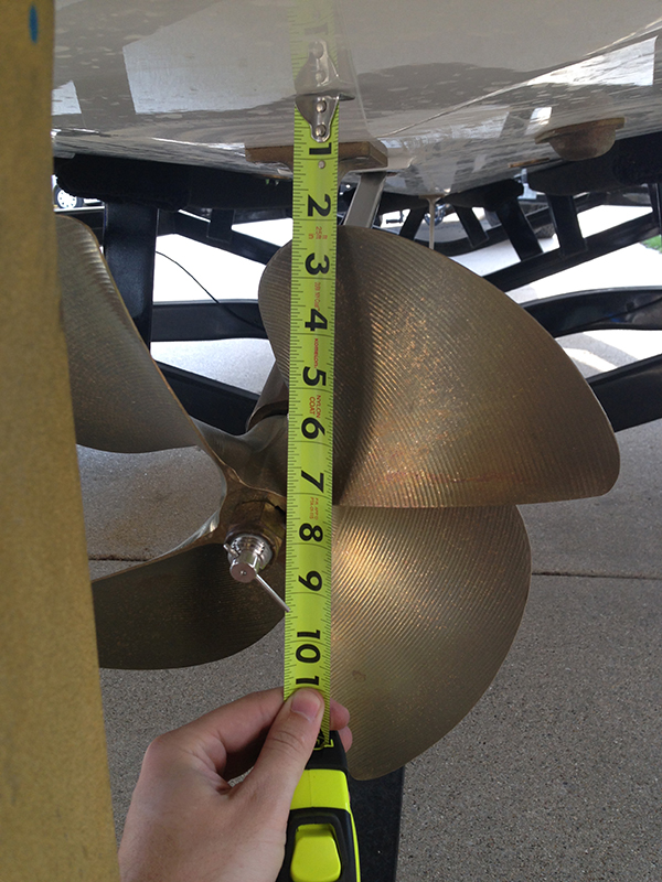

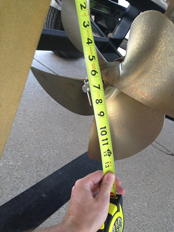

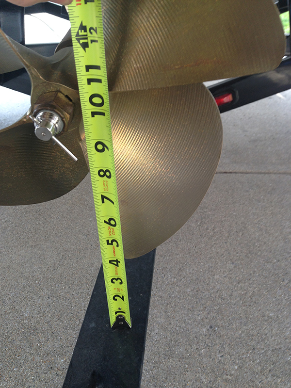

So everything I see on here says to get the 2315, and that's the way I was going to go. When I looked up the prop guide for the axis boats here http://www.wakemakers.com/axis-wakeboar ... propellers it recommends the smaller 2079 (14.5x12" vs 15x12") Why is this?
My a20 came standard with the acme 537 (13.5x16). Will I have clearance issues with the 2315? Anyone with an a20 running the 2315, everything I seem to find is referencing the a22 and the 2315

You shouldn't have clearance issues with the 2315 but it seems the 2079 worked good with the A20. The 2315 is for A22 and A24.

after a few pm's with the admin, 2079 is on order! Ready to hit the lake!

I'm running 2315 on my A20. No clearance issues at all.
