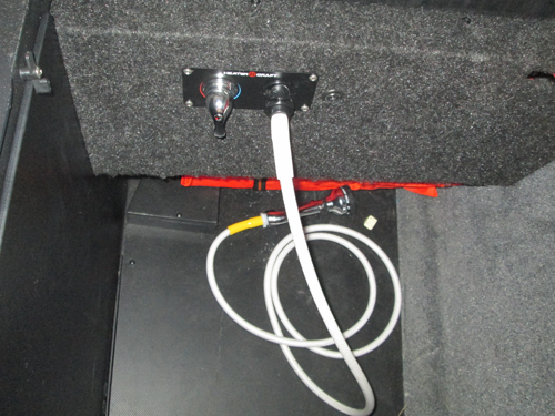

Hey Team Axis
When you get a chance, could you take few pictures of your installation. Where did you mount the pump? Where did you mount the hot and cold valves and sprayer hose? I want to mount them under the swim platform if possible and not cut a access hole in the back of the boat for the sprayer hose. I am looking for ideas before purchasing the heater craft kit

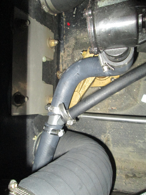

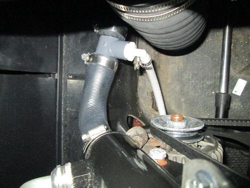

Hope this helps. Can get more this weekend if you want me too.
