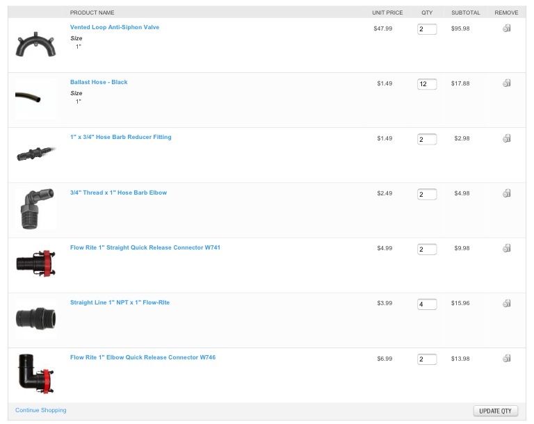

Here's the list of parts needed to do both sides; It came out to about $160
