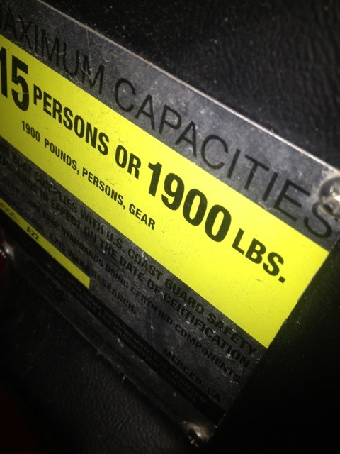

PostPosted: Thu Oct 10, 2013 8:56 am
FYI.
I had 8 in the boat last night with no one in the front. With room to spare.
