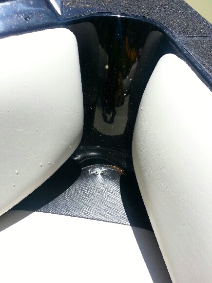

This is the spot in mine, was in each corner of bow, Malibu re did the seats under warranty, my choice I asked them to do them in white, and have since had the axis logo deck trak cover supplied my Malibu also under warranty.

Mine look almost identical to the pic above. Tried to upload pics but kept saying the file was too big. I'll have to get one of my kids to show me how to fix that. Going to bring this (and a few other things) to the dealer soon and see what they say. Thank you all.

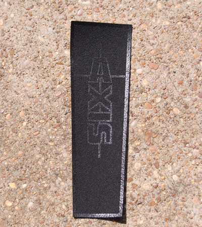

[quote="AJWest"]I guess the Malibu/Axis engineers didn't think the curved gel coat would act like a magnifying
glass and burn/melt the vinyl.
quote]
Exactly what is happening. The only fix they offered was a black Axis decal to put in the corner to break up the sun beam.

PostPosted: Thu Jun 25, 2015 9:11 am
The deck-trac isn't bad on a black boat but an eye soar in my opinion. I choose to just use a towel but have considered ordering a small sheet of Agenda traction. It comes in lots of colors and a few patters. Plus it doesn't look like industrial safety tape like the Axis stuff does
