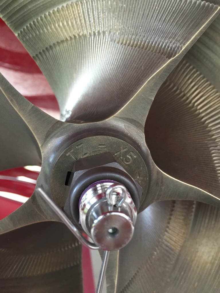

Been trying to read and figure out what prop to buy, and I think I just confused myself. I'm running a 2013 a22 with the 350hp. 900# in each rear locker, 950 bow bag and all factory ballast. Most of the time we have 4-6 ppl. And no wedge. Currently running a 5 blade tz x5. But it struggles to plane when fully loaded with 7-8 ppl in the boat. What prop do I need as I damaged mine this weekend? Thanks

I went from that OJ prop to a 2315. Some good info on this thread - http://www.wakeboatowners.com/viewtopic ... 8&start=50. I boat mostly around 400' but spend a month around 3400' and the 2315 has been great. It's definitely been an improvement.

I'd say if you're currently struggling with that prop to try the 2315, big step up from the OJ5

2315 for me 2013 A22 330 750 rears, 600lbs lead midship, 950 bow.

Im normally at 1000' thanks for the answers. I was thinking the 2315 was the one I needed

I had a 2315 on my 2014 - Running about the same Bags as you. It is perfect - My 2015 A22, it has a 2313 (Pretty much the same as a 2315), but it is not working. I'm running 4,000 rpms surfing, my 2014 was running 3,000 rpms surfing (Its drinking some gas) - I just ordered a 2247, after reading many posts about the 2015 A22 - If it works out (Find out by Thursday) I would part with it cheaply.

My buddy runs the 1235 on his '13 with 750lbs rear sacks and the wedge down, arrow full and it gets on plane. He also has the same engine. You should be able to get there with the 2315 or OJ945. The wake will be pimp. Throw a 400lb bag in the nose to make it even better.

I just put a OJ945 on my boat and WOW, the difference is amazing coming from a 1235!
