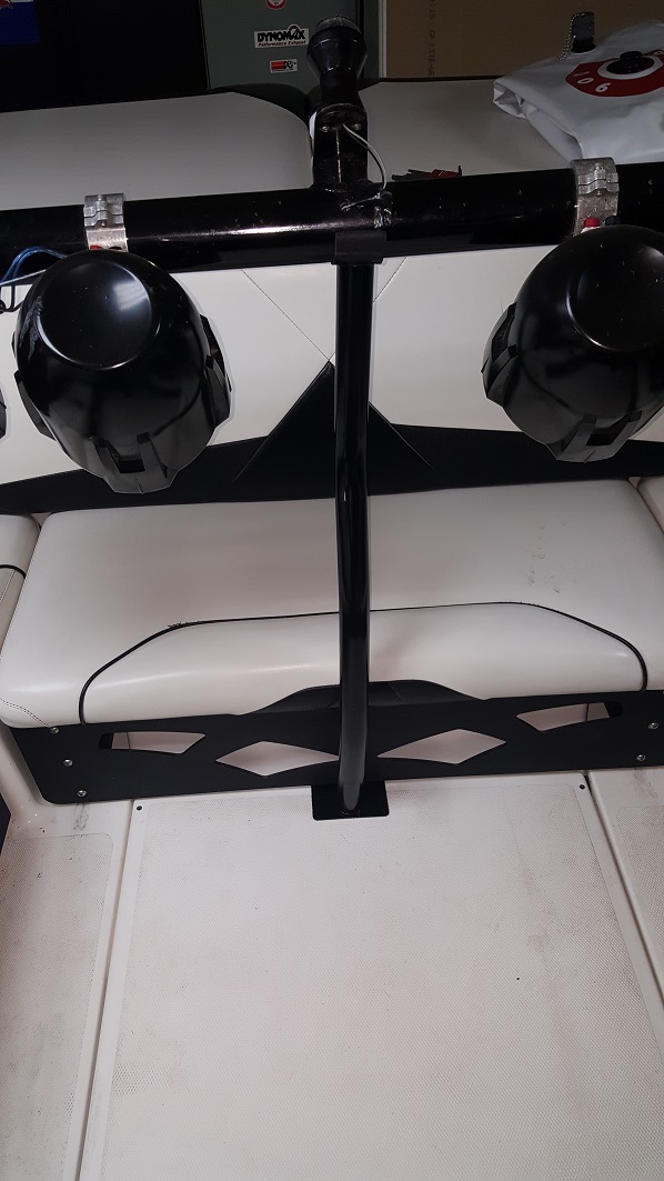

My buddy made this to hold our tower up. Rubberized undercoated the bottom of it. You could trailer with it if needed even, the bottom plate has a lip that goes under the seat also. I can take more photos if you have the means to bend a pipe up.

I made a similar support out of a 2x6 with a "V" cut at the top to hold the tower and then a wider piece of plywood at the bottom. I used a piece of foam rubber at the top of the "V" to prevent scratching the tower. I also have the same speakers and agree they are very heavy, so I wanted a wider support base at the bottom of the 2x6

2x6 and 3/4" plywood to evenly distribute the load across the fiberglass... I have 2 410s... WAY HEAVY.
