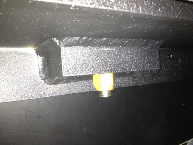

Walter wrote:
Yes please, pics would be helpful, also has anyone noticed any stress cracks in the gelcoat where the brackets bolt to the boat on the inside?
Looks like mine was much easier to install than some. I haven't noticed any stress cracks in the gel yet. Hopefully they don't show up...
File comment: Bracket from below
File comment: View from top
Zak
