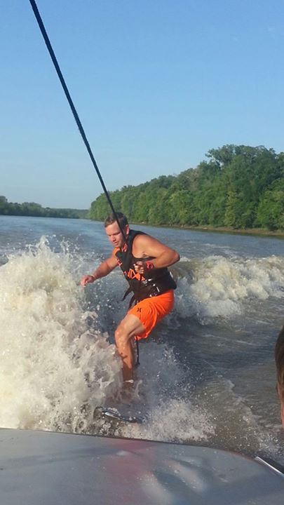

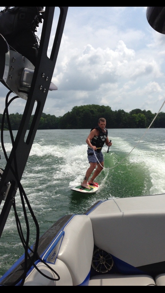

Here's a pic from today when I was teaching a co-worker how to surf. He got it right away but the wave was pretty spot on. Setup was: 750 rear locker, an older 800lb bag under the bow filled a lil over halfway, center tank empty and a 550lb on the surf side floor. Wedge up and speed around 11.6 (not calibrated - prolly closer to 11.4). Only myself in the boat and older swim platform. Wave was pretty meaty for just one person in the boat. About mid thigh high, almost to his waist. Attachment:Image

That's a very clean wave for the first generation platform

This is what I get... wtf

 Post subject: Re: Wakesurfing set up
PostPosted: Thu Jun 27, 2013 9:19 am
Ive seen that before. Wedge up, more bow weight, little faster, and steer boat slightly to the left.

That is with 750 sack full in port rear, almost full front 950 bow sack under the seats. 3 adults on port side bench. Speed was around 11 set on the cruise control
Holy prop wash :shock:

Have you ever calibrated the speedo with a GPS to ensure that it is accurate?

No I have not. Are they off that much from factory?
