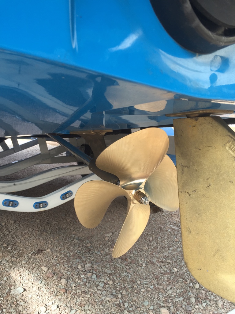

He recommended the OJ945 for mine. Here is my install. New Gearing

Let me know how your new prop testing goes when you get to use it. Very interested in how it is compared to stock. I will be running the same ballast and motor as you in me T23.
