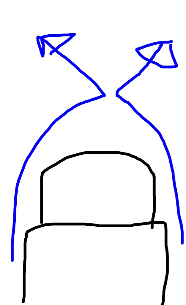

So I guess what I need is how does the water respond coming off transom
Is it like this

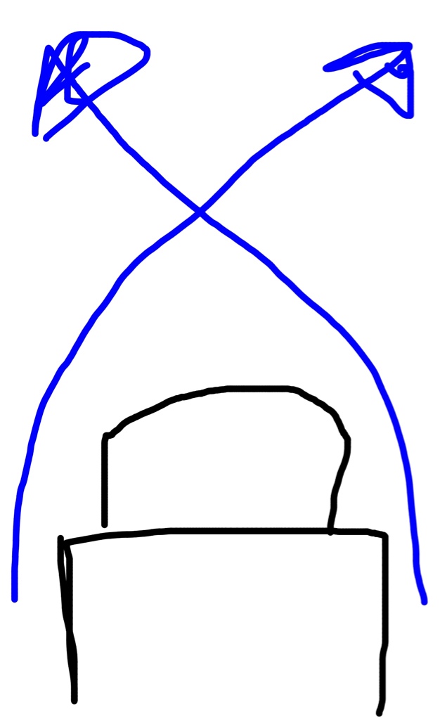

Or this

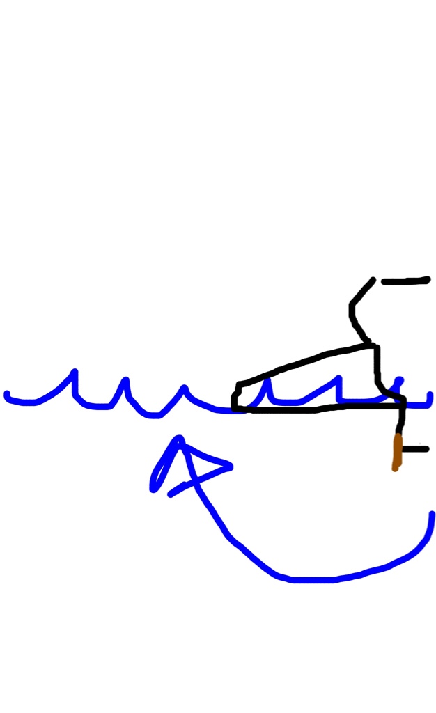

Also how does it respond coming off the bottom of hull like this

Its delayed convergence like this:
The water have to take a longer path on the non-surf side, so the crest of the wake shifts to that side. If the NSS (or delay) is too large, then the wave height suffers. If the NSS (delay) is too small, then the wave is not clean (white water).
