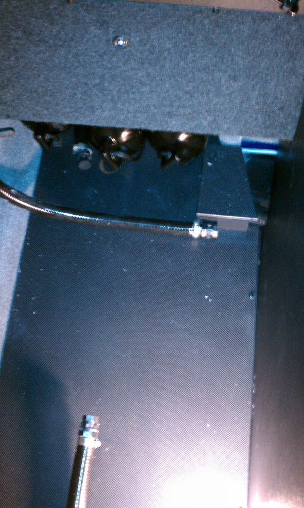

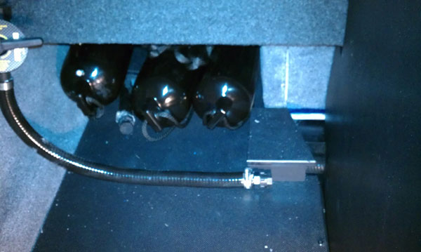

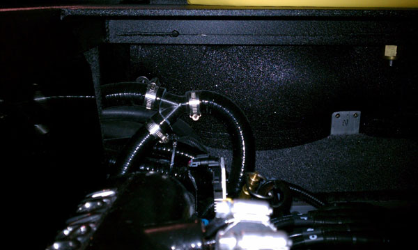

Just picked up my 2013 A20 Axis, I am looking for assistance on connceting up my plug and play. The new Axis plug and play has 1 1/8 hoses, larger pumps, a new valve up on the gunnel, two drain hoses, and I do not see any vents in front of the engine. I replaced my 2011 A20 with a 2013 and was planning on using my old sac's but it looks like that's not an option. I will post up a few pictures, anyone else have a 2013 Axis and tried to connect up the plug and play. I was told that the new sacs need to have two drains one on each end panel.

From looking the system at the boat show you are able to choose which tank/bag to fill first. If you want to just fill the hard tank without sac you are now able to. If you choose to fill plug and play sac it will fill the top bag and flow to the hard tank. The system is supposed to be amazing. The top hose hooks up to the top of a sac through a bigger fitting. The lower hose of course goes the the drain. Hit up boardstop. He can get the larger fittings.

I talked to BFI today. The new Axis bags do come with 4 fittings now. They have added a 4th fitting to the Axis specific bags. I have an email into Axis to try and get more information on the new 4th quick connect.

Malibu has changed the system at least two or three times since the 2013's started shipping last year. This is the newest and hopefully the last configuration.
Good news. The over priced bags that Axis had Mike at BFI make are no longer needed. Now you will connect the fill hose that comes off of the valve to the top of the bag and the rear drain hose to the drain port on the bottom of the bag. You can use a standard fat sac and will have one port open to use the W749 Air Release fitting. I like to install the Fly High bags with the W743 and W746 fittings so that the bags can be removed easily.
I have also been experimenting with using the Straight Line Sumo bags in place of Fly High as they have a 1" port instead of 3/4". We have noticed better flow through the Straight Line 33057 fitting and the Fly High W746 fitting. Remember that we are relying on gravity to get the water from the bag into the factory hard tank for draining.
