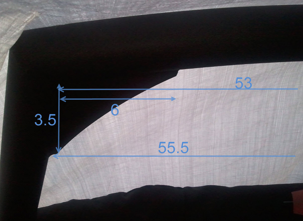

Does anyone have access to their boat where they could get me a measurement of the cross bar at the top of the tower where you'd mount speakers? I am trying to plan out what I need for my system and it'd be a huge help to see how much space I have to work with up there. I also posted a different thread, but if someone could see if the wetsounds 808s would fit in the stock locations in the interior it'd be awesome. They are 8.89" overall. Im just worried about how tight it'd be in the bow! Thanks in advance

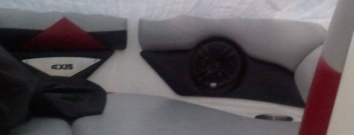

These dimensions are from an 09 and I'm not sure if the bow has changed enough to allow for larger speakers. In my case the speakers are 7".
The tower has 53" of space inside, but less for mounting due to the corner supports. When you drop below the corner tabs it increases to 55.5". The 3.5" dimension is measured vertically. The corner supports are 6".

Thanks a lot for the pics. I was hoping 2 pairs rev 10s and a 410 in the middle would fit but it won't :(

I wanted to add another pair of rev10's, but you would have to add them to the sides- or up on top of the tower. the 410 with 1 pair of rev10's sound awesome though. Make sure you give them enough juice!
On the 808's you probably can get them to work, but you would need to cut the cushion panels and then reattach the vinyl. Have you considered keeping the 6 1/2 and adding the 808's on the floorboard panel?

Yea I have thought of just 808s in the play pen and just 6.5s in the bow. Sounds like the way to go. I assume 808s will fit in the playpen?? I had 4 rev 10s on my old boat and kept one pair. Looking at adding a 410 in the middle this time around. I didn't want anything mounted up top so the "5some" is out of the question I believe. I should b ordering soon and ill do the install myself. Ill definitely post up pics.
