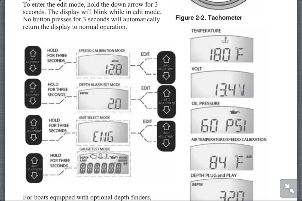

When I purchased my boat it had the depth alarm turned on. I had the tach and/or speedo replaced and since then it has not worked.
How do I turn it on and adjust it?

The process should be somewhere in here, around page 23, hold down the info adj button for 3 seconds while in depth mode to adjust alarm
http://www.m2omarine.com/resources/Axis_2011manual.pdf

THANKS Walter!
