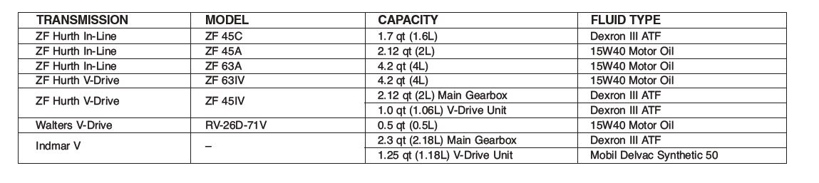

Do the vdrive and transmission both use the same oil? Or does it depend on the vdrive? I have a 2013 A22, and with the season starting up I want to change these fluids out and haven't yet.

Found it.
