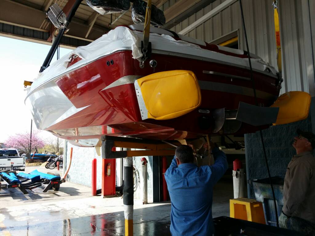

This was mine at the factory.
[attachment=-1]uploadfromtaptalk1400875985599.jpg[/attachment]
2014 Axis T22

Yes. Every boat is lifted that way. They water test every boat and that was mine getting the prop put on. I was actually allowed to walk under it and I was asking questions about the different ports on the bottom. Other than the stitching on the upholstery that everyone seems to have problems with...no. There were supposedly a couple of spots on the gelcoat that my dealer had the factory fix before I took delivery. I guess that's a benefit of living close to the factory.
