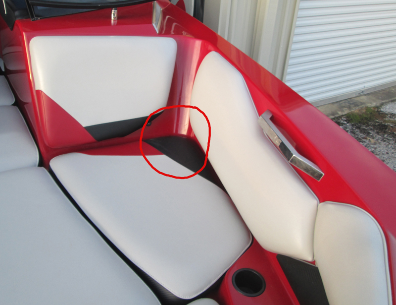

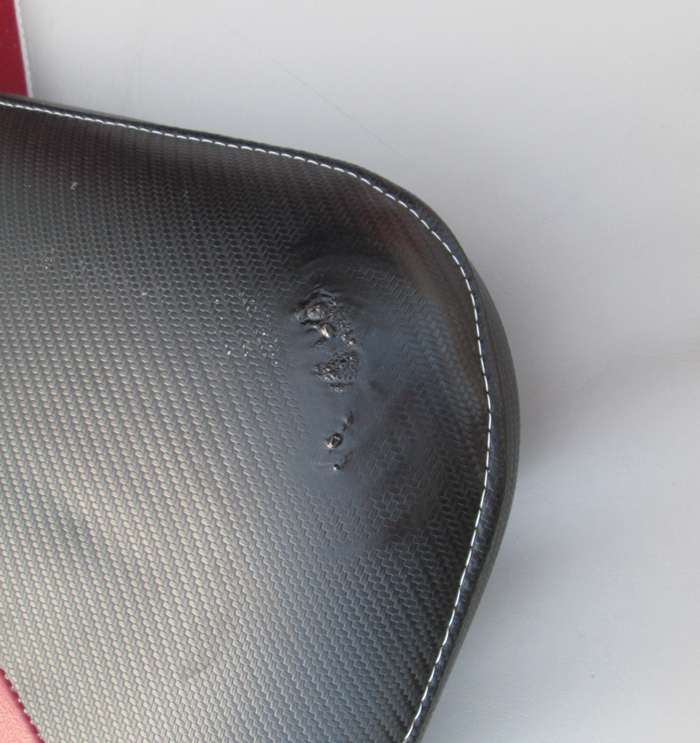

Need input from all of you about a problem with my bow skins.
In the bow there is a problem with my skins that came from the factory that way. Wanted to see if anyone else has had this problem and the cause of it and Axis solution to the problem.
I noticed the problem last summer and was going to wait until the off season to get it addressed only to find out that the year warranty has expired by 6 months. This is an obvious problem that occurred at the factory and I wanted to see who all it has happened to and Axis solution to the problem. Feel free to chime in SDUKES cause I know you had the same problem.
I will post pics below but it looks like something has burned the skins in each corner.
Shame on me for not handling it earlier and contacting the dealer or Axis about it. I was just wondering since it came from the factory that way do you think they will give me a break on the year warranty and handle this for me...?
Thanks for any and all input.

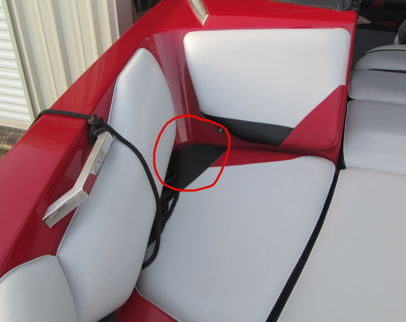

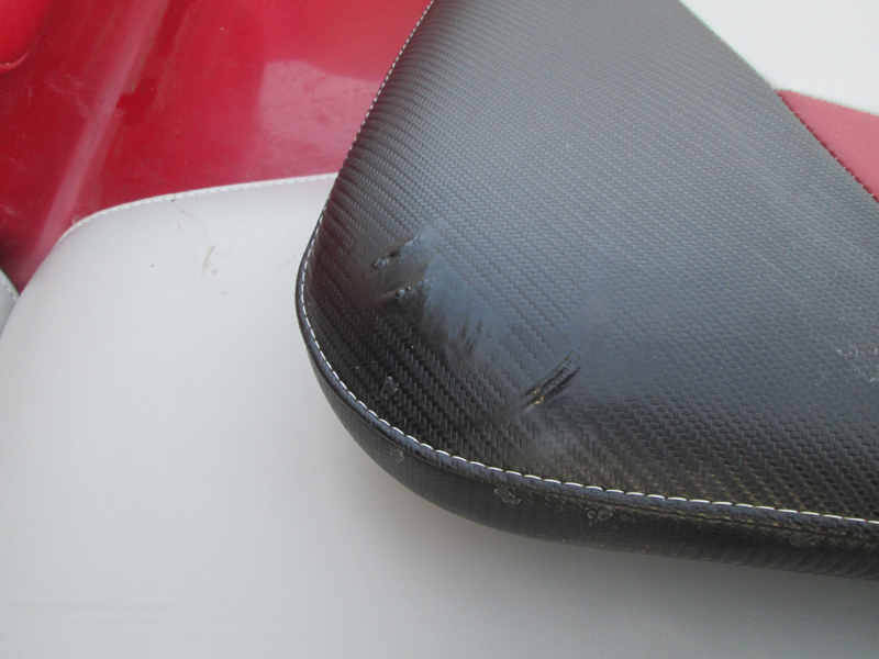

Starboard Side

I have a couple of those in the exact places but mine are smaller. I didn't notice either for a while. Mine are about the size of a quarter
 Post subject: Re: Skin problem in Bow (from factory)
PostPosted: Thu Dec 26, 2013 9:37 pm
This is a common problem, especially in white or grey boats. Those 2 corners of the bow are concave and they reflect the sunlight right onto the cushion, like using a magnifying glass to burn ants or start a fire. Axis/Malibu definitely knows about this and will replace your skins. They try to fix it by changing that corner black piece to white or light grey on the new skins, but according to my dealer, and common sense, it will happen again. 3 of my 4 bow skins were replaced with the same exact color way and in one day (hot day in havasu) my skins did the same thing. It looks like someone tried to melt it with a torch.
The only real fix would be for Axis to have a 1 piece back cushion that continues in that corner instead of 2 pieces that have that big gap. As for now, there are no real fixes from Axis, just have them keep replacing the skins every winter.
