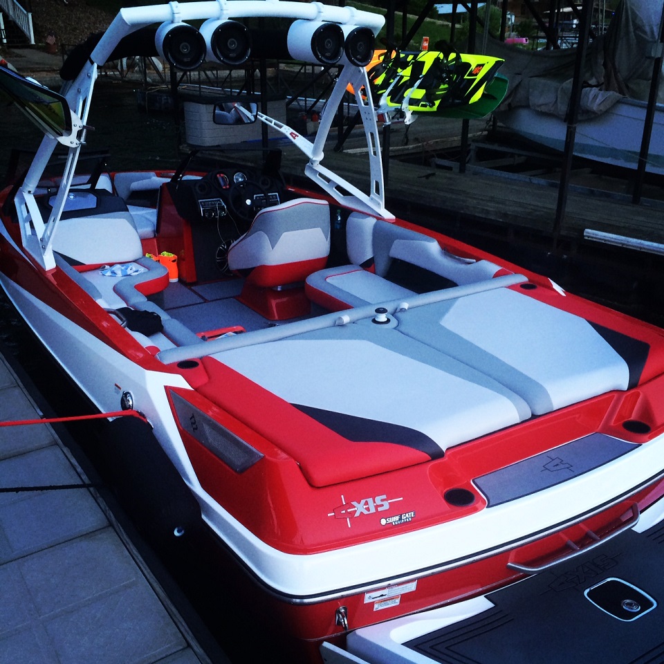

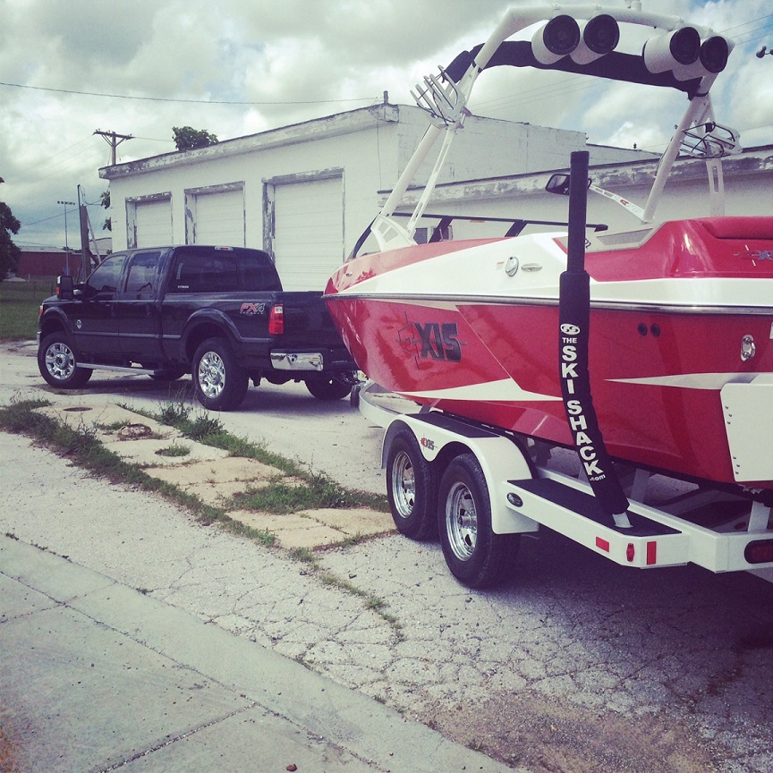

Awesome, I ordered the 2315 yesterday from Boardstop.
I have to take the boat in for a service next week, so I will be sure to have them check on
the tach issue. Here are a couple photos.

Looks great- You're gonna like the 2315. Post up some pics of the wakeboard wake (loaded down) when you get a chance. Several of us are curious to see how it compares to the A22.

That interior looks great!!!!!!!!
