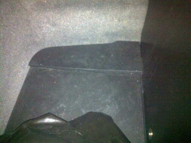

The drain pump should be in the far back under the plastic cover, just remove a couple of screws and pull off the cover, all the way back against the transom, the piece of the floor that's raised up just a little
 Post subject: Re: Rear pnp tank not draining
PostPosted: Sat Jul 12, 2014 6:41 am
Right here

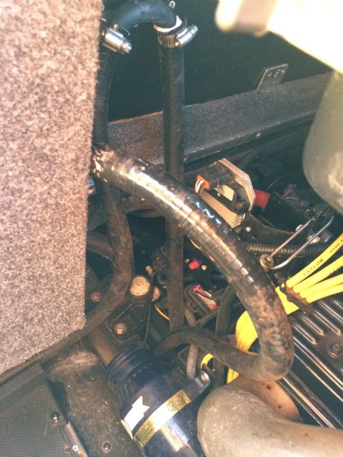

I pulled the drain hose off the pump and it's pushing water out. Put the hose back on no water coming out the side. So the hose must have a kink. I traced it from back of the tank but can't find how to see it under the floor.
PostPosted: Sat Jul 12, 2014 9:15 pm
Joined: Wed Jul 09, 2014 11:48 pm
Posts: 17
How can I tell if it's kinked between these points? It's not kinked anywhere past these.

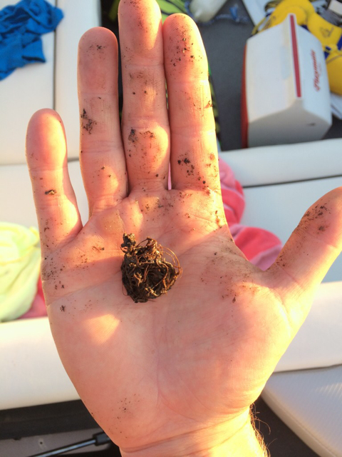

Ok found the culprit
PostPosted: Sat Jul 12, 2014 10:26 pm
Crazy how that didn't get tangled in the pump but stuck in the hose instead
