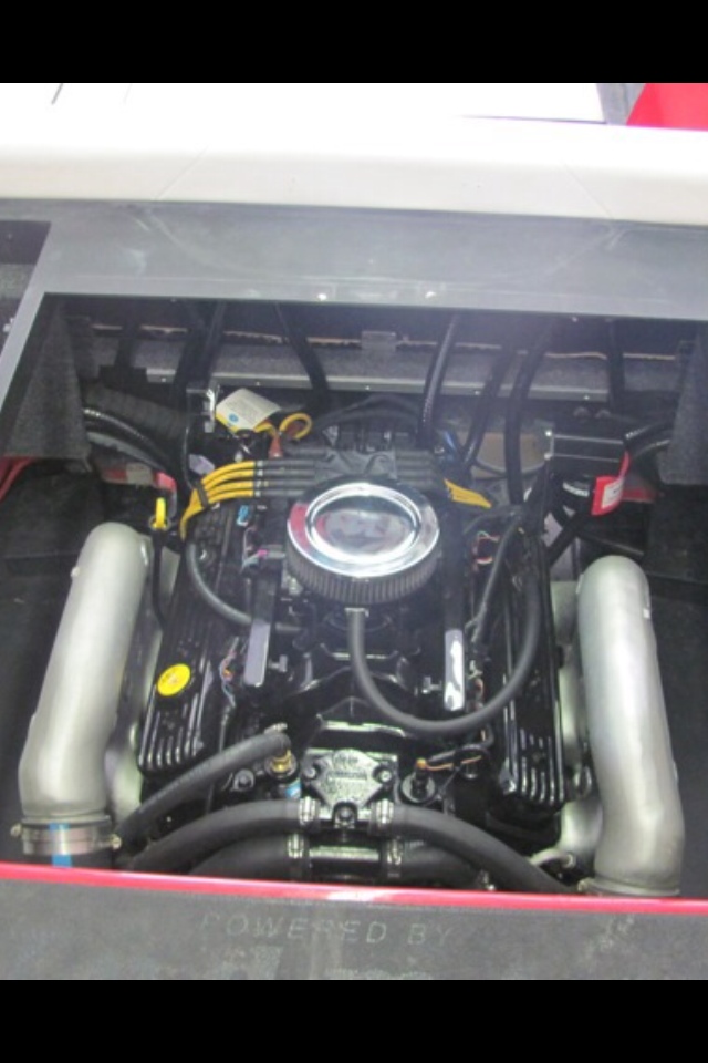

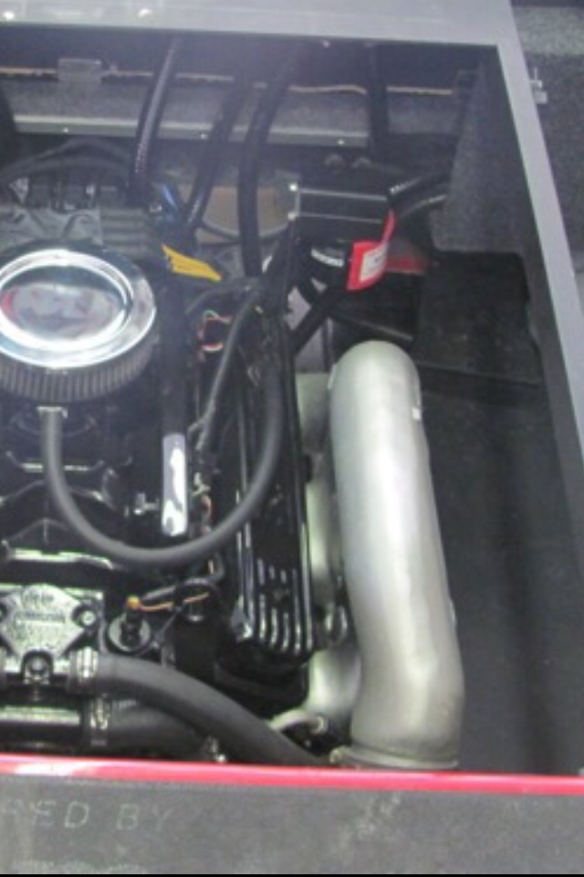

if its perfectly round in circumference then it has catalytic converters, if its more oblong in shape then it probably doesn't

Here is a non cat manifold on my 2010

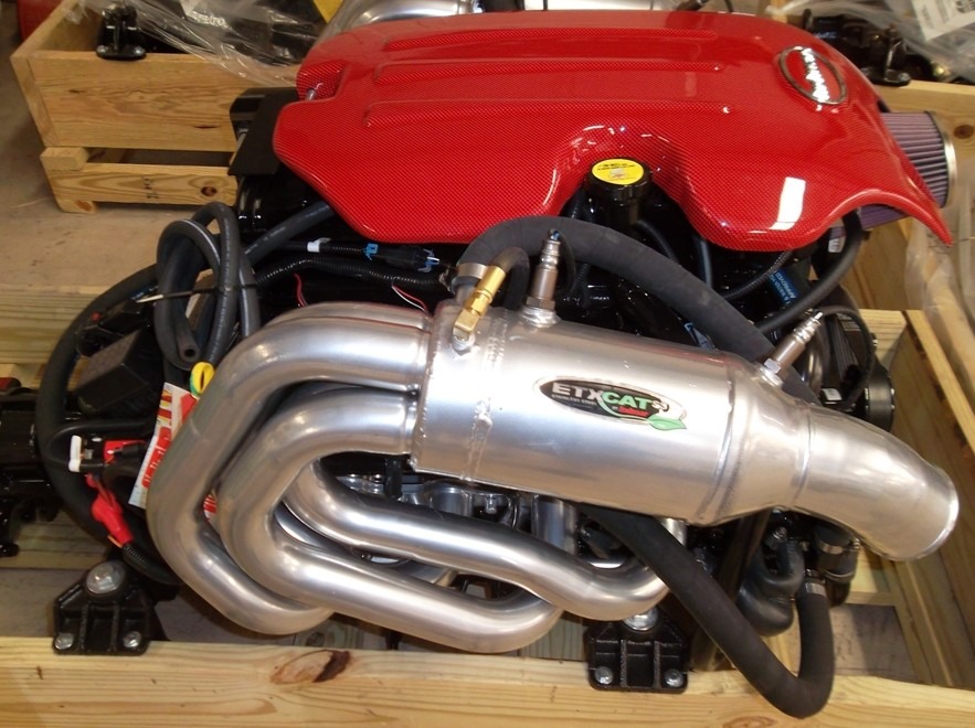

Non cat manifolds will probably be cast iron and have a textured feel on the surface, cat models will likely be cut out of stainless steel and have a large section 6-10" long where the catalyst will be installed and they usually have O2 sensors in the rear of the manifold by the hose connection similar to this pic

You should see 2 oxygen sensors about 8-10 inches apart on each manifold. no oxygen sensors no cat
