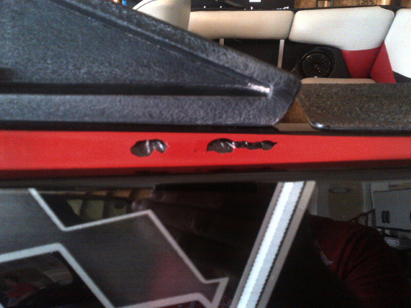

Anyone know how to fix this?

Are you planning on fixing yourself? If so, you're probably going to have to get the gelcoat color from Axis directly. That looks more like a gouge than a crack.

I actually repair boats and cars for a living. Go to your dealer and get them to order the gel, the color is a really good match.

Did you hit something? Or was there a bubble under the gel coat?
I would get the color from the dealer for an exact match.

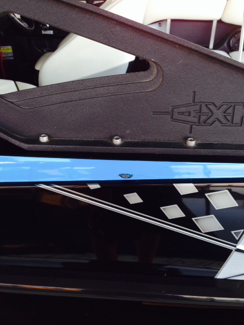

Mine did that in almost the same spot and the dealer fixed it under warranty, it was like a bubble under the gel coat..looks good now!

Thanks for the info. Yea I was hoping to try and do it myself. I just bought the boat a few weeks ago and the boat came like that.

That was why I asked. If there was a bubble under the gel boat and it popped. then I would have the dealer fix it under warranty. I have seen that a time or two and both times the dealer fixed it under warranty. Almost around the same area. Check your warranty before you try and fix it yourself. I would not repair it myself since it is in a pretty visible area.
