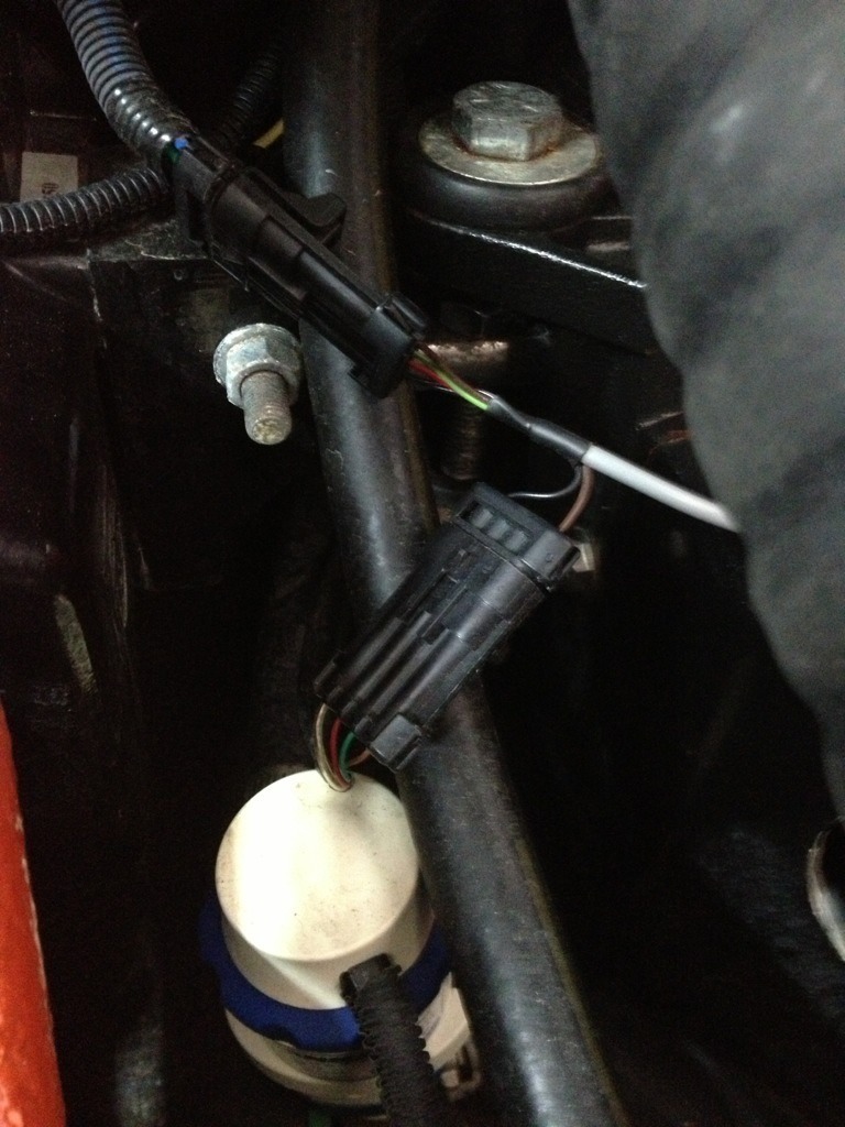

Check the connector for the transducer, right below the chillax seat on the port side, next to the thru-hull pump for the rear ballast, may have moisture in the connector causing problems. Here is a not so good pic I took when installing my GPS

Thanks for the image and suggestion Walter. I will take a look at this area tomorrow and report back on whether I'm able to get it fixed.
