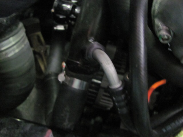

It's behind the driver side panel just below the trans cooler

Ok so I was able to get a look/listen at it. The screeching is definitely there around the 2k rpm range, but it's very faint. Whenever it fixes itself it gets much louder and then stops (though I couldn't make that happen today). Anyway, I let the boat sit there at 2k rpms for a bit and watched my voltage drop from 11.6 down to 10.0 over about 3 or 4 minutes.
I can call my local dealer for the part...but how hard is it to replace the alternator? From what I can tell it's held in place by 3 bolts, but maybe there's more to it than that. Anybody done this before on our engines? I would prefer to not have my boat sitting at the shop for 2-3 weeks to get this done.
