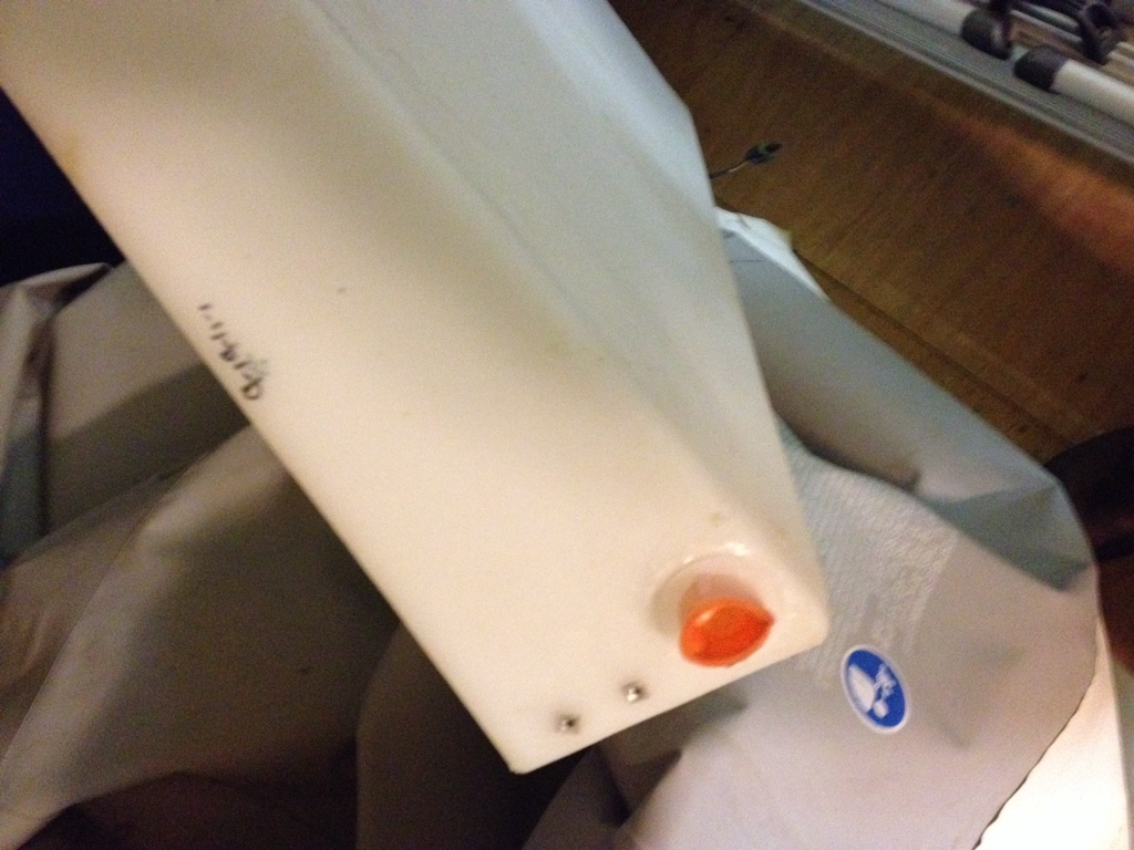

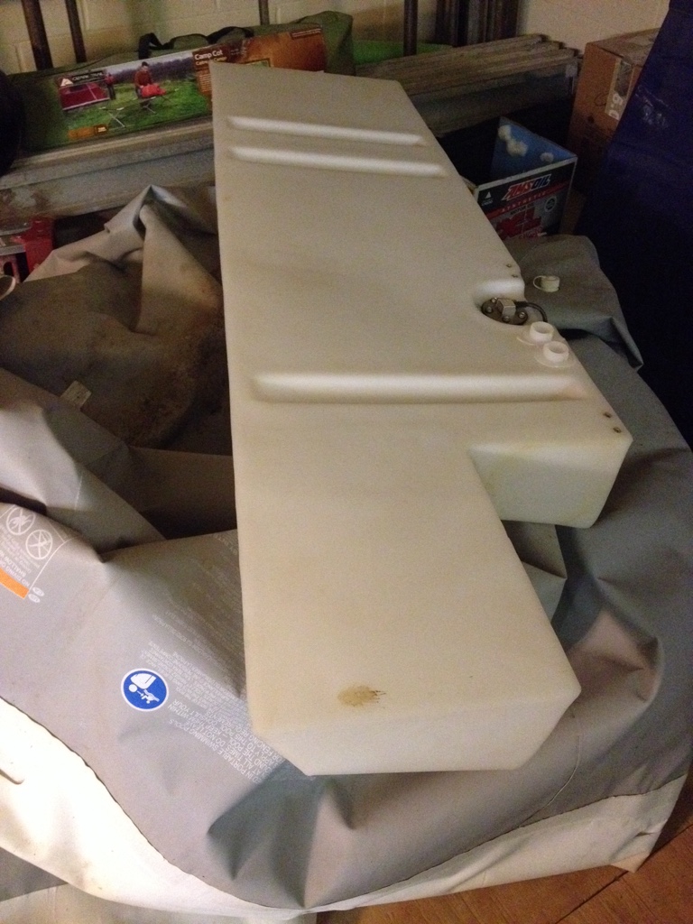

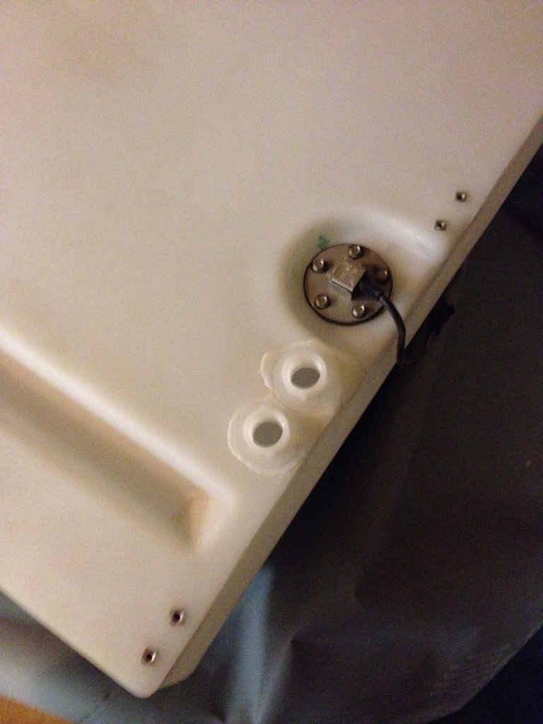

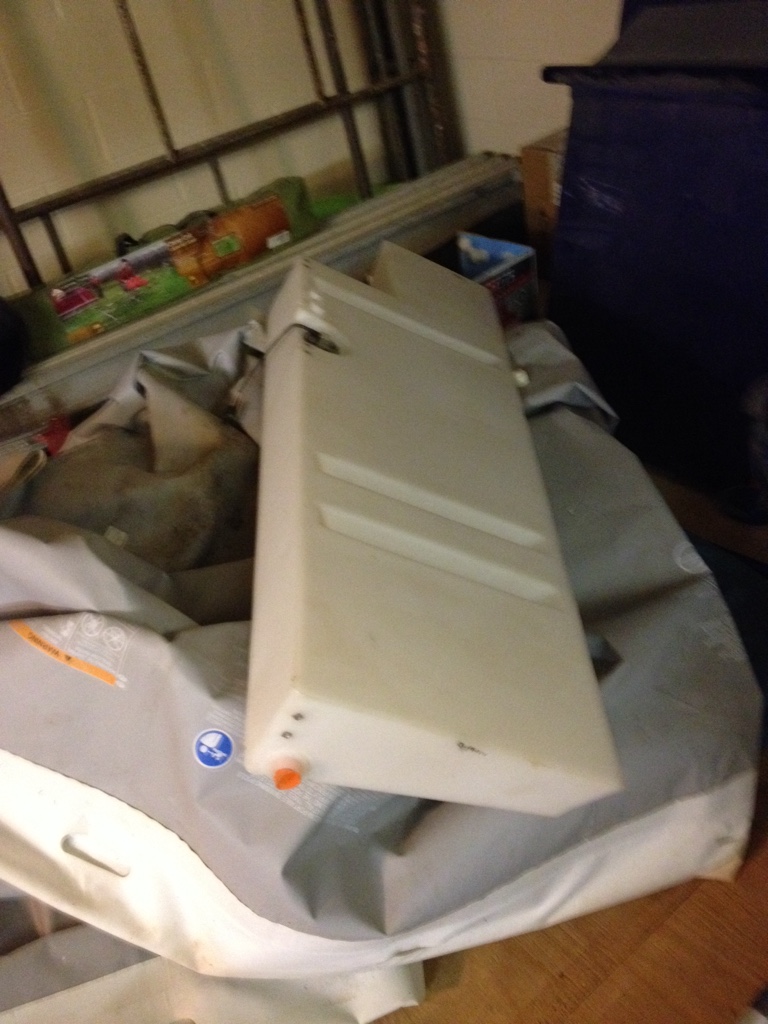

Has anyone seen a ballast tank, outside of the boat. Are there any thread plugs that are un-used, especially on the center tank? I've been trying to chase down a water leak and have literally re-done every ballast fitting on my boat. I've also check every possible area that can let water it: swim platform, underwater lights, tracking fin, drain plugs, raw water cooling lines, exhaust, shaft seal, bow hook, etc.
The water is definitely leaking in-between the stringers and I'm confident its related to ballast. I've put dye in all the tanks, EXCEPT the center, and had clear water in the bilge. All the fill pumps don't leak either. I am literally lost on what it could be. My only idea now is maybe the ballast tanks have plugs in them that are leaking that aren't visible.

I have a rear tank I can get a pic of tomorrow

That would be awesome. As for the center tank, it look like the fuel tank has to slide out first haha. That'll be a fun little project.

The only extra the rear tanks have are the floats that Malibu uses for their automatic systems

Oh wow those pictures were perfect. I don't see any other plugs except for what looks like a float gauge.
I have a heater, but I have a salt series. No coolant is leaking anywhere.
