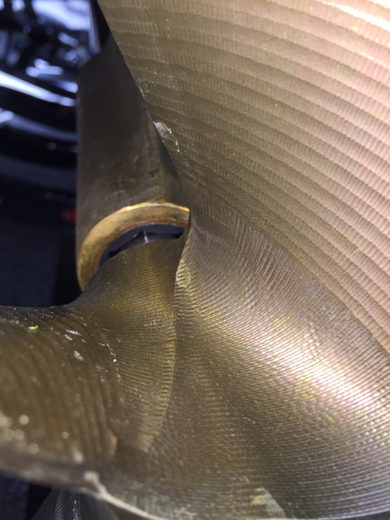

We were out yesterday and got a rope wrapped around the prop shaft. After a struggle with a dull knife, we were able to free it. Everything seems fine but after inspecting this morning I'm worried a seal may have came out of shaft coupler(not sure if that's the correct name). Can some post a close up pic of this area?

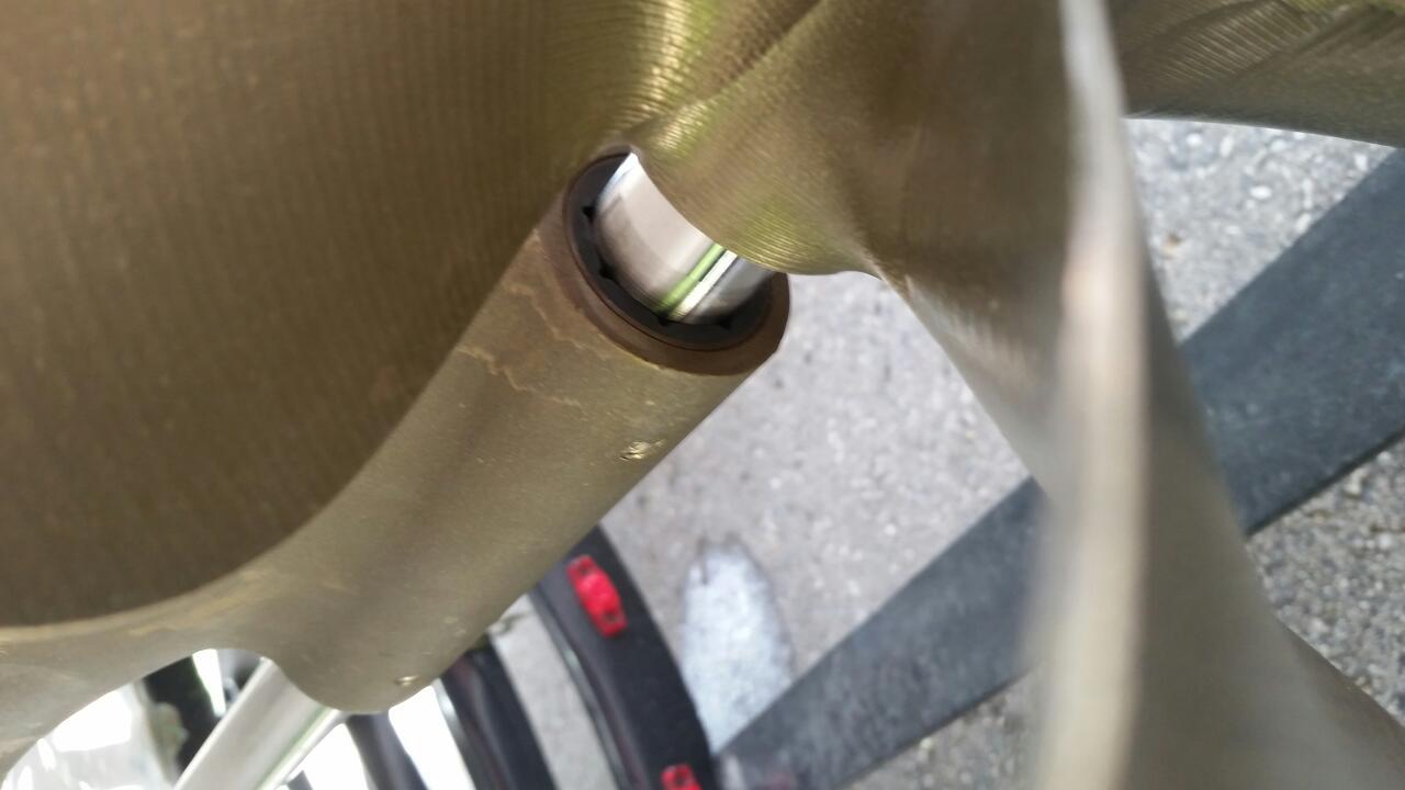

Best I could get.

Stop worrying. Besides the loss of the rope, you look good to me.

Thanks 3oh2rider! I hope so dezul, I was thinking it looks like a seal or ring is missing when comparing the pics.

No problem. It looks like if anything it may have pushes the seal in some. I don't think a caught rope would rip a seal out but the way it tightens around the prop and shaft maybe just squeezed it in some.

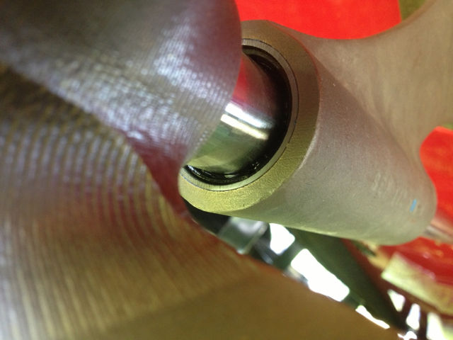

Here's a pic from a different angle. I'm pretty convinced something's missing. The other side of the coupler looks identical to 3oh2's pic.

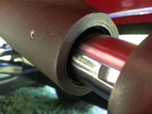

After searching a little further (bakes.com), I've decided there isn't a seal there. It's a strut bushing. and there is two in the coupler. Mine appears to be pressed in a little. I'm going to keep an eye on it and see if anything changes.

I think that rubber bushing goes the length of the strut, if it just damaged the last 1/8" i think you'll be ok
