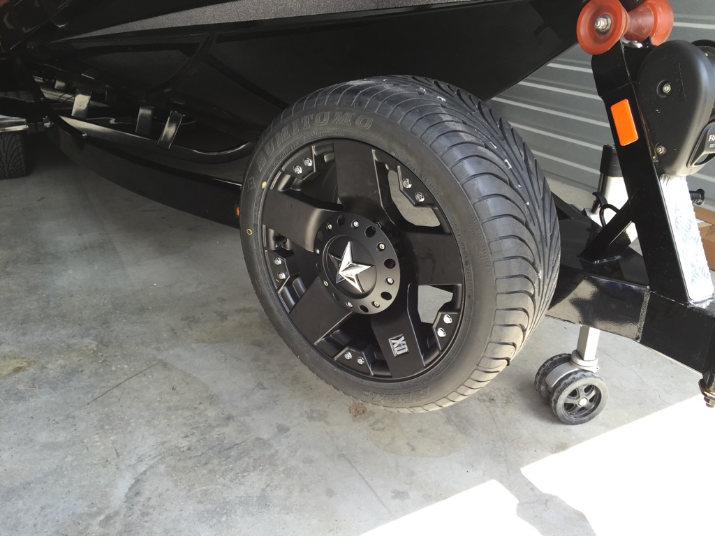

I purchased this wheel to add the Rockstar spare to the tricked out trailer. It has two bolt patterns drilled but has the correct 5 lug pattern and backspacing. The tire needed is a 255/45/18.
XD-Series Rockstar XD-Series775 Matte Black Wheel (18x9"/5x114.3mm) https://www.amazon.com/dp/B0025KUZ6W/re ... Ovb7RZPTS6

Bhowell yes I got 18 those are the exact ones thanks for the help.
I knew the tire size but that didn't help with the rim and bolt pattern and offset spacing

From everything I can tell, that is the correct wheel. You could call Boatmate to confirm. The spacing is the most important point as Rockstar is now putting dual bolt patterns in most wheels to allow for more applications for the wheel. Since I couldn't find the single drilled 18x9"/5x114.3mm, I ordered a dual drilled (the one I linked to). I actually had a flat this past weekend and had to put it on and it fit just right.
