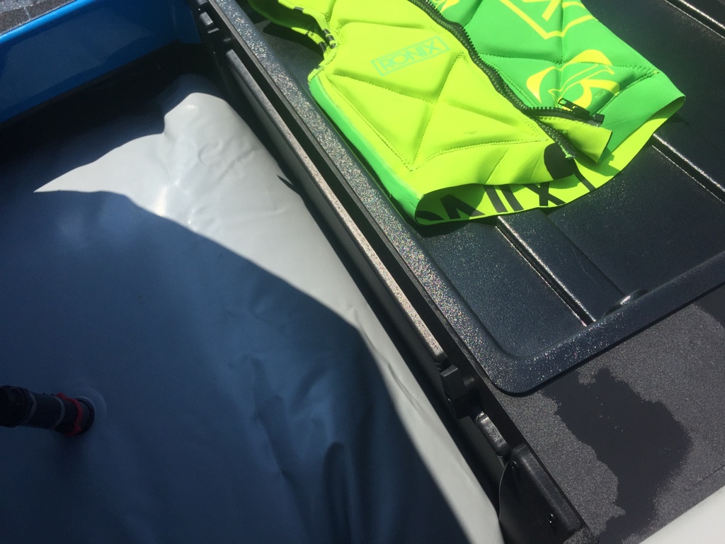

Mine is reinforced but has some flex still.

I'm just about done with my mod. I'm using 3/4 treated plywood for mine. Put a aluminum 1/2" "L" shape on the floor right up against the weak existing wall. I used short screws to hold it in the floor. I also put a piece on the back section where your bag connects, up against the weak made wall. I wrapped my plywood (on one side) with a black shipping blanket for now. I will put some poly batting and marine grade vinyl, latter on. Fabric.com seems to have some good prices and u really don't need that much material. I ran the plywood up to the top, allowing the top door to close. I used 1 1/8" deck screws, pre-drilled 3-holes on the top and bottom. The screws barely came through on the bottom, but we're fine on top. We tested it (one of them) on Sunday, no movement at all. I'm sure I could got away with regular plywood instead of treated, once i wrap it, but the weight will not matter in the rear end anyways. Plus I'm only wrapping the bag side, the other side will be up against the weak existing wall.
