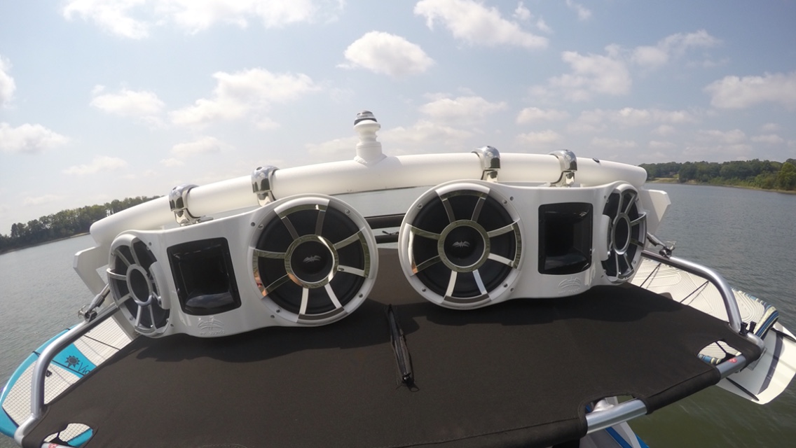

Looking to add a smaller LED light bar to our tower to be rear facing. My concern is mounting it and potential interference with the stock Bimini boot. Any pictures or suggestions on where or how to mount something like this?

I installed them on my 15 T22. I'll take a picture tomorrow and post it for you. I placed them in each corner, facing the wake. No interference with Bimini. This pic was with lights on at dusk. Image

My neighbor has a 2009 23 LSV that he has rear facing lights that work great. The thing that they have that makes it work great is they sit just under the Bimini and it provides a brim that stops the light from hitting the rider in the face.

Here's the pic of the lights. I chose the ones with two rows and not as wide as the one in you image. You'll see that I mounted it to the corner bracket. It's nice and close inside the corner and can't get snagged on rope. This could be mounted to face forward for those that would rather be seeing forward when they drive in the dark. LOL! At first I had bad hum in my speakers when lights were on but we were able to fix it by grounding independently.ImageImage
