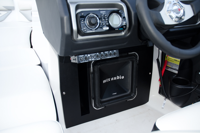

PostPosted: Sun Oct 16, 2011 6:56 pm
Any of you know if this steering bar can be taken off to install the sub enclosure?
Here's the box I went with
I have yet to install it. Waiting till it cools down a bit outside.
PostPosted: Sun Oct 16, 2011 9:46 pm
Posts: 10
@nastya20 - I didn't have any clearance problems. I removed the front seat and slid it in. It was an extremely tight fit. If my box had been a 1/4" longer in any direction it wouldn't have fit.
