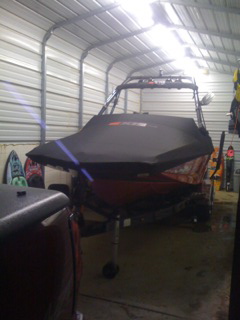

Just tucked mine away too, filled it up with gas and sta-bil, ran the engine for an hour, changed the oil, pulled the drain plugs and blew out the heater hoses, now all I need to do is find some of that spray they recommend putting on all the bare metal surfaces like the steering shaft and motor mounts and things like that
