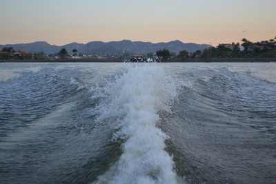

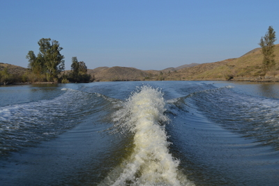

AJ West... as requested.
speedo was calibrated last summer and is correct +/- 0.2 mph.
cinco prop at 19 mph, the slowest I could have a clean wake with 4 adults, 600 lead, and another few hundred in residual water in the rears. full fuel. bimini up. slight winds, 10mph?
core prop at 18 mph, the slowest I could get a clean wake with 4 adults and 600 lead... first test of the day so ballast was completely empty and dry. full fuel, bimini up, slight winds at 10?
full ballast pics are poor due to bad light and the winds picked up. for sure the cinch made a cleaner wake face, no noticeable change in roost.

1st pic is the core
2nd is the cinch.
sorry they are so small, had to resize them so they would fit. you can see the 2nd pic of the cinco how bad the water got.
