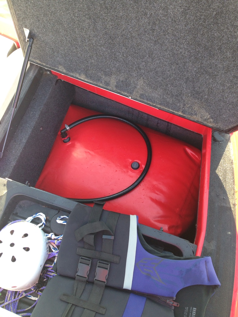

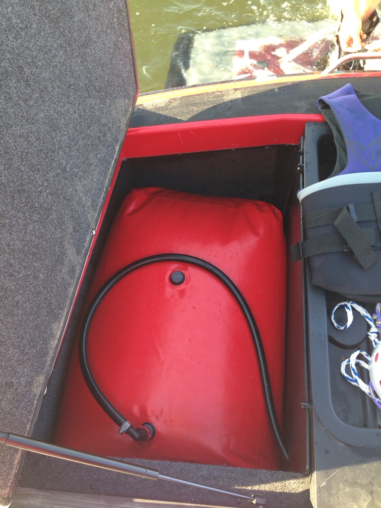

Mine are somewhere in the 700-750 range, fits great and fills completely

What year is Johnny's boat? My 750s look like they take up less room on top of the hard tanks then Walters without the tank. I think Walter's is 10 or 11.
