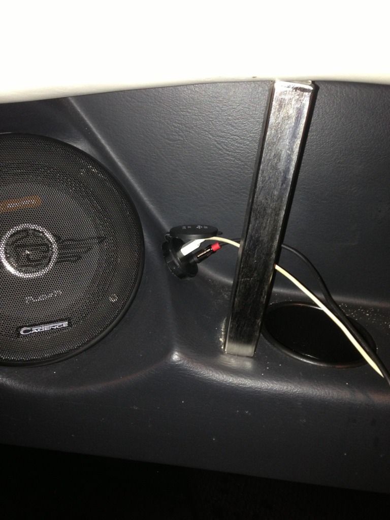

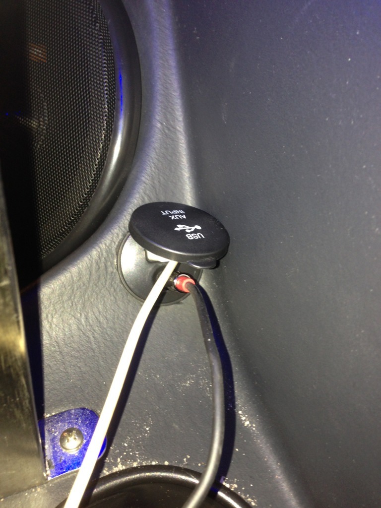

I got this AUX USB port from amazon made by SeaWorthy. Installed in the same place as the 12v plug is on drivers side hardest part was running the cords to the radio.

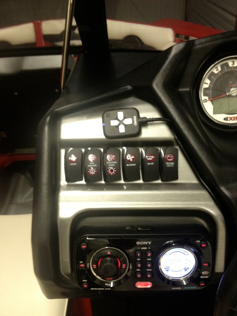

PostPosted: Wed Feb 13, 2013 7:53 am
My Sony HU reads my iPhone if I plug the phone cord directly into the USB cord on the radio, it just doesn't work with the extension for some reason. I picked up a clarion hands free blue tooth for around 50$ It hooks up to the aux RCA inputs on the radio, it works really good but doesn't allow use of the pause or other functions on the radio, pretty much have to use the receiver to skip songs, taking calls works good and it's easy to hook up, bad thing is I think it's discontinued, every website I found it on says its out of stock and clarion doesn't list it on their online catalog any more.
