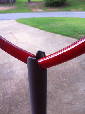

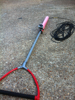

OK Gang. Here is my set-up with the GoPro. Really easy to do.
Section of PVC conduit cut down to 4'. May actually cut this down further once we get some shots and get camera at a proper distance. Right now we are at about 3' from handle V.
Used my Dremel with the sander attachment to make the V section for the handle to fit into.

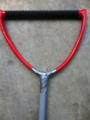

Duck tape to attach handle.
Swim noodle on end for flotation.
GoPro handlebar mount to attach to PVC.
