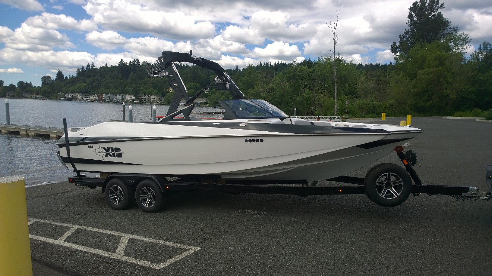

Thank you and here is a picture from the day we did the demo :)
