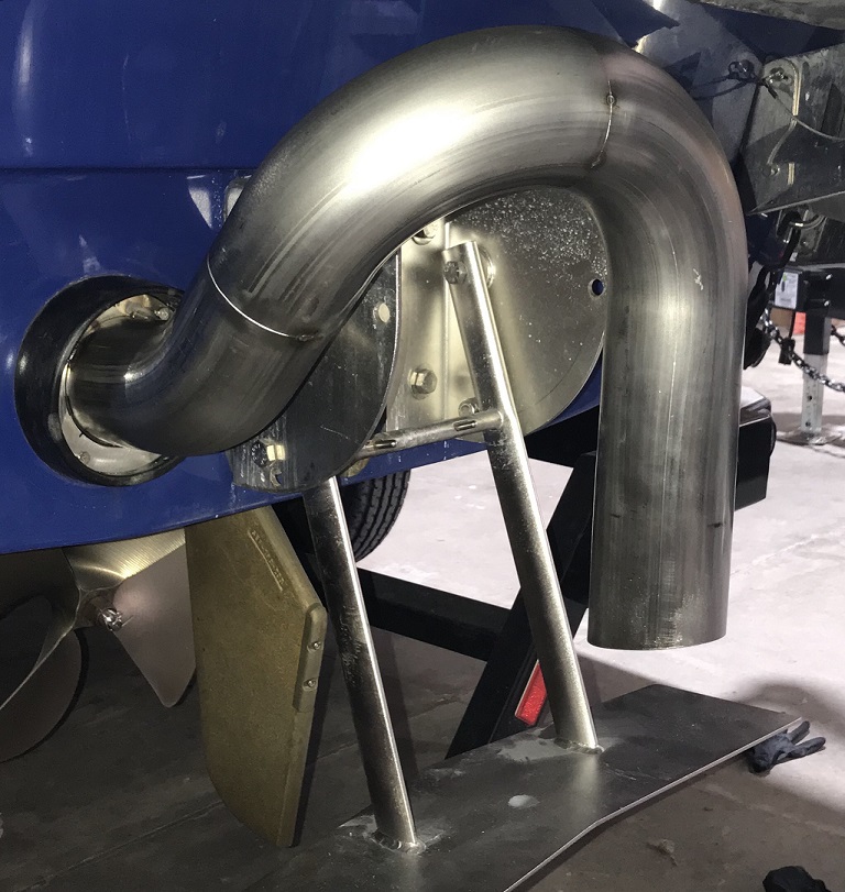

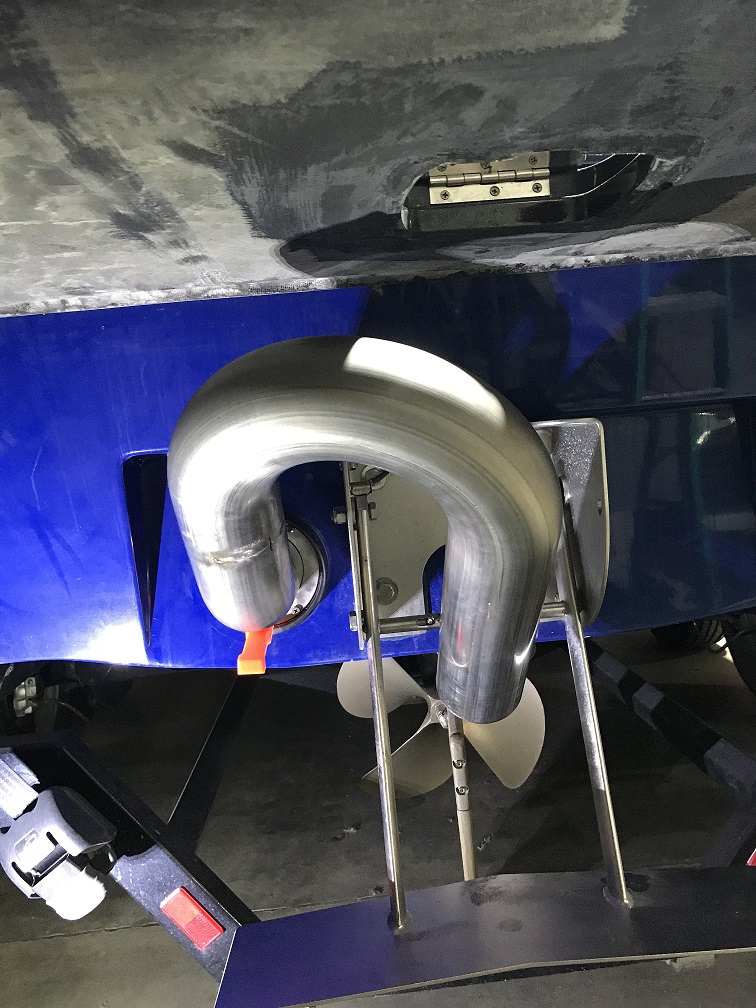

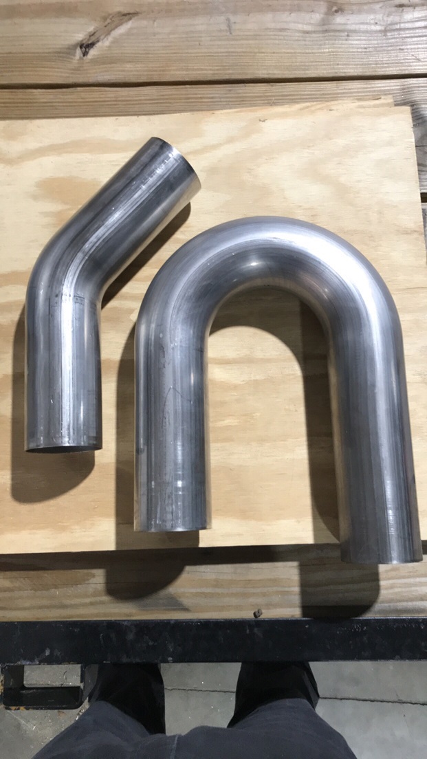

I decided, mainly because im cheap, to make my own surfpipe. Bakes had one for almost a grand, and i heard one from a dealer would be at least that if not more. I think the FAE designs are terrible looking. I mean, its 2019 and they dont even use mandrel bends for the easy setups. So, being the fabricator, welder, and machinist I am, i made my own. It was pretty easy really. I have about 130 bucks in the thing, and took probably 4-5 hours. Let me know if you have any questions.
